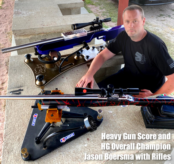

From the Accurate Shooter (current) Home Page:
Note the Heavy Class rifle at the top of the page.
