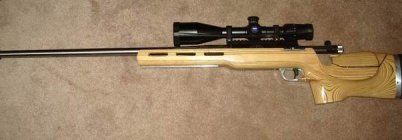

Barnard with a Mastin Palma Offset Stock
Barnard Triggers unmatched for quality, ease of adjustment

Barnard with a Mastin F Class/ Benchrest Stock supporting a 9 pound Bartlein barrel. Barnard Trigger second to none in quality and ease of adjustment.

The Space Gun is a Gary Elisio/ Competition Shooting Stuff B1 Stock that was done almost 2 years ago. Chambered in 6XC with a 32 inch TrueFlite from Steve Blenkarne in New Zealand. Rear sight is an RPA ARW Trakker along with a 22mm RPA front tunnel. Rear grip is a Foxbat so it moves my hand farther back. Garys design and work is really awesome. I have a lot of respect for him because he thinks outside the box.
The second rifle is chambered in 6XC with a 29 inch TrueFlite tube. Stock is a Mastin Palma Offset. Optics are Zeiss Diavari 24x56 from Alex at Euro-Optics. Scope rail is a 25moa made by Mac Tilton of MT Guns. This one can go optics or irons as needed same as Scott Parkers rifle. This action is actually taken from the first rifle above. I am more comfortable with the traditional wood stock layout. Its just a personal choice.
Third is my most recent build. Chamber is 6.5x55 Match using a Bartlein Barrel F/Class profile 5R with a 1 in 8 twist. I went with the 6.5x55 because the Barnard can really exploit the higher velocity's that hide in this cartridge. It will not burn up barrels like a 284 does. The wood is a Mastin F-Class/Benchrest that I finished myself. Scope rail is 25moa from Mac Tilton and a second Zeiss Diavari 24x56. I just shot this one last weekend for the first time and currently working up loads.
On all the barrel work was performed by the legendary Mac Tilton of MT Guns. The scope rails are of his own design and the quality of his work is reflected in everything he does.
I am not writing to sell anyones products or services. Mac, Steve,Gary, B&M Enterprises and Mastin are known throughout the shooting community and reputations speak for themselves. I only endorse what I know by personal experience.
The Barnard Model P action is a simple stout design. Burly is the right word to describe it. Its features are user friendly and the bolt can be disassembled for cleaning without tools. Tolerances are held to a uniform minimum . Machine and finish work first rate. No blue printing needed right out of the box. Bolt is a 3 lug design. Working the bolt is a one finger operation unless you jam bullets deep. If someone is looking for a light weight action the Model P may be too heavy but Barnard has a solution to that- the Model S which shares the Remington 700 profile. The Model S cannot be compared to the Remy though, its on a different level.
Another benefit of the Barnard is the V- Block bedding system used in the Mastin stocks. Simple, easy, interchangeability of actions,no problems with loosening or wear of bedding materials.
