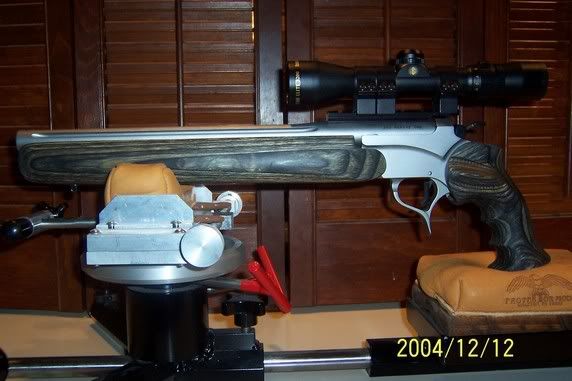

Being new here, I'm alil late on this as well as some other threads, but I find this C&J rest an exception value with windage top for under 350$ I believe. I pd like 290 something afew years back.
The only thing I modified on it, so I didn't have to pick it up to move it. I D&T next to the leveling screws and put heavy duty roller balls under it.
Sorry, not the best pic for full view.
