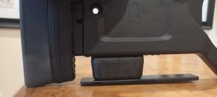

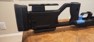

This is what retired guys do with their time. Rather than spend the $40 for a KRG flat bag rider, I decided to make my own. 1/4" x 3/4" x 5 1/2". Mounted on the small Xray bag rider, Gen 3 and earlier. Replace existing bolts with longer bolts and different head. Counter sink the aluminum piece. Black rattle can after primer on bolt heads and aluminum bar . Pretty good for the bench and squeeze bag (that's my preference). Or if you want to chase varmints (this is for a 223 build), you can remove it all or return to original configuration. Anyway, for the bench, a longer flat, smooth bag rider is getting close to my MPA flat bag riders, at a significant discount.1000004133.jpgIMG_20250605_170136810.jpgIMG_20250605_165902503_HDR.jpg
