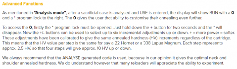

Here is a snip from the annealer manual that explains the connection between the code values and hardness changes. The short version is that each step in the code changes the hardness value about 2.5 HV.
