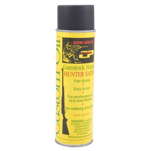

I'd wet sand that sucker with thinned finish. Use about 400 grit wet/dry paper and thin the finish with mineral spirits. The sanding dust will mix with the finish and go a long way toward filling the pores. Once good and dry, lightly sand again and put a couple of coats of this on it. Nice looking stock!

I like that idea of that spray can finish. I'm going to give the arrow wood a season to prove its self. The product you linked to was the other option I was considering before I went with Arrow Wood. Also, it's what I will use as a top coat if the Arrow wood if it doesn't provide the protection I'm looking for.
It's surprisingly good stuff and very easy to use. Hard to beat, really. I'd take my time on it and give what you have PLENTY of time to cure before doing anything else. If you sand too early, it tends to pull out of the pores. Just give it a week and see where it is. Either that or wash it down in acetone to get most of it off and start over. It'll leave a good bit behind and what's left will dry mucho faster.
That aerosol is awesome, especially the satin. They have a high glass version too. You have to spray it in much lighter coats or it will run. But the satin, holds very well from runs. Just don't get crazy and follow the instructions.
I'd still get the pores filled as best you can. The aerosol will eventually fill them but you'll need to sand between coats and it'll end up looking like a finish that's "on top" if you get it that heavy. Get the pores filled, get it very dry and put a couple of light coats of the linked stuff down and see what you think. Just my two cents.
I'd use the satin. If you want high gloss, I'd start very over and use auto clear.
