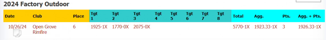

Re Competetive: Here are my scores for 20251756392635220.png
But like @dusterdave173 said I am in 8th place with a 2331.33 aggregate although I still scored a 2500 card but my aggregate for Xs was zero.
