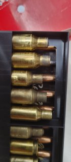

Ill take a pic, its like the cutter was chipped or dragging a burr. Kinda rough. I might try polishing, i have done that before on other barrels.
after running flitz in there on an old case. that looks pretty rough to me. didnt fix it, not really surprisingly tho. i cant polish that out.

Well, after that i remebered they had a no reload clause in the warranty.
This barrel was a warranty deal for poor accuracy and the bolt pierced factory ammo.
If i want to push back the shoulder more each time or dont reload for it, its fine. I bought a eabco 22" barrel on sale today, ill try my luck with that.
Reloads didn't cause the issue, poor manufacturing did. Send that back and make them do it right.
Finally got around to asking BCA about replacing the barrel. I asked if i could just send the barrel back and they were ok with that.
I told them i wanted to replace it because the chamber neck looked like it was cut with a drill bit
