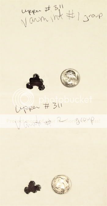

For pure accuracy it's hard to be a set up like this - incorporates all of the above items (muzzle brake has a special heavy 3/4" x 28 TPI threading).
Here at the first two 5 shot test fire groups at 100 yards with the above upper - second group tightened up from first - "smokin"
That's not very accurate. You missed the dime both times :P
