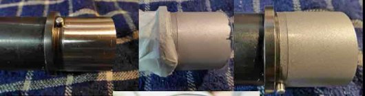

Doing some measurements before I put another upper together.
Will get the borescope out and take some pics inside.
The barrel extension has a taper from 0.999" to about 1.000" . Intentional?
Light tapping and it still doesn't go all the way into either BCA Side Charge Upper.
I will lap and use my spray on shim, freezer and oven to put it together.
I wouldn't do anything to the barrel extension. When they are a tight fit [which is good!], I hold the upper in a upper 'block' in a vise and, holding the muzzle end of the barrel so it's even with the upper, I tap with a plastic mallet until the extension is fully seated. When it's tight, the taps are not light.
I don't think it matters, but I tap on the outer edge of the barrel. Since the crown is recessed, it almost for sure doesn't matter.
It's tight for the last 1/4" or so.
Every one of mine I do a true thermal fit.
Barrel in freezer, upper receiver in the oven.
I spray a thou or a little more of rattle can High Temp paint let it cure and polish it smooth.
This makes for about a 0.0015" to 0.002" interference fit that can only be assembled with a temperature difference.
Hand tighten a barrel nut and let temperatures equalize.
It will still be tight when the aluminum and steel are heated up after 3 20 round strings of fire.
Since the extension is mostly supported by the body of the receiver, not just the threaded nose.
The extra metal in the BCA side charging receiver probably helps and just has to offer more stability than the normal light weight receiver. I want the entire contact surface between the extension and receiver to be a thermal fit. Not just the last 1/4".
I can get the barrel to about 70F below ambient (4F), Receiver about 150F above ambient (220F) for a delta of 290F. Working fast it's probably 240 or so by the time I get things together.
With a coefficient of expansion for 7075 Aluminum of 13uin/in/F that's about 0.002" expansion and 6uin/in/F for 416SS gives about 0.0004" shrinkage. If I hurry I can easily slip the painted shim extension into the heavy walled BCA receiver and hand tighten a nut to hold it.
and that is optimum for a barrel and upper going together. You dont want any chance of movement.
I like your plan..very nice. I built a Grendel that way also with a X-Caliber in 26 inch and a plus 2 on the gas.
It shoots real well too.
