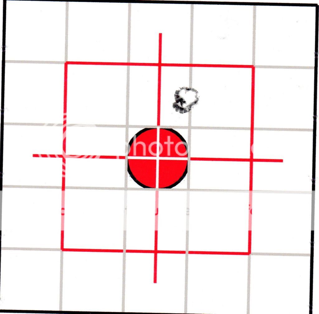

Well here are the results. Granted I found a load .4 grains over the suggested max, and I didn't get the velocity I was hoping for.... I'm not going to complain.
Load: 42.8grn AR Comp, ES 4.5, SD 2.8, Avg. 2790, RWS Brass, F210M, Comparator OAL 2.300" (.014" off the lands)
Off of a bench w/ bipod and rear bag. CTC .116" in a three shot group. I feel that if I had 5 shost, it probably would still be under .25" (assuming I didn't throw one).
I should also mention that all my loads were within 26fps as an ES with this powder. I started at 41.5gr and worked my way up to 43.5. 43.5 gave me speeds of 2882-2908fps. The groups started to open up after my first accuracy node. I didn't continue because, who can complain about what I have? I'm most certainly not too concerned. Most of the groups were less than 1" at 100yds. I have one other group with 42.6grns that measures .361" That is with the cold bore. It is obviously the group before the keeper. I was watching them come together as the loads were changing.
