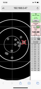

I competed this weekend in a Palma match with a 223 AR Match rifle 26” barrel with a +2 gas system using 88 ELDM bullets on e targets with no issues. 2800 FPS with a LARGE amount of 8208 in LC brass. It was over 1300 at 1000 with decent SD at the target in high winds. 6C50C353-20BB-4E1B-A155-8F0C2BD5C30E.jpeg
Hey thanks for the replies. Nice shooting Jeff, those ELDM's getting launched at 2800fps? How confident are you in the MV, did you verify it with a chronograph or work your way back from the terminal velocity? Also what was the temp on the day of the match?

It back calulated to 2800 ish from the Etarget twice. Once on a cold day at 100 yards and Sunday at 70 degrees, 40% RH at 700 ft. ele. This is in a 7 twist too.
