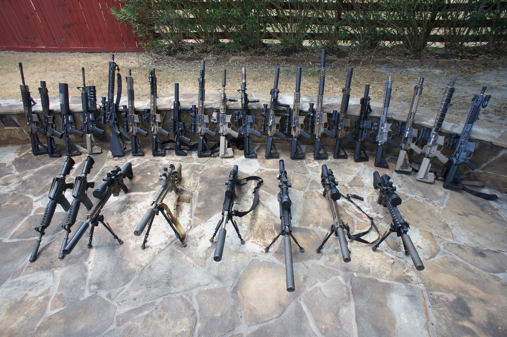

I built, tuned, Cerakote, and reload for every AR and M16 in this picture.
+1 on WOA and +1 to faxon. WOA I feel is best for service rifle and heavier profiles. Faxon has a great 18" with rifle length gas port called the Gunner profile. No side by side the two don't compare; different purposes, but both I'm happy with. 1/2 MOA from faxon at 100y; hmmm sometimes, but not "all day.". More like sub-MOA "yes."

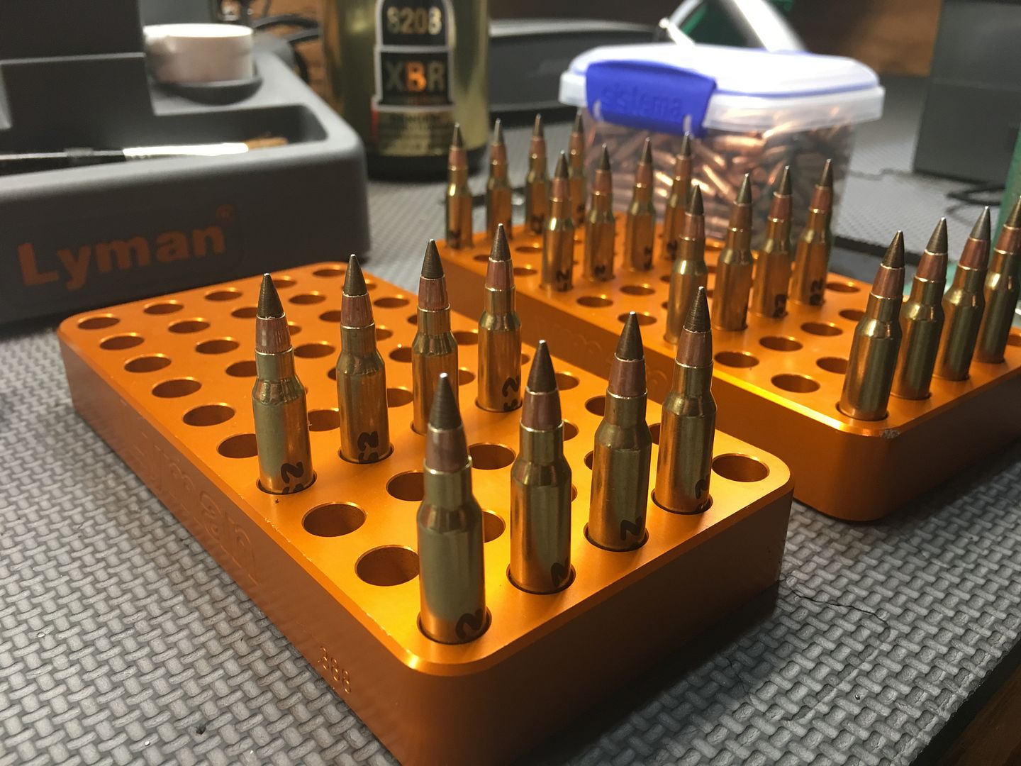

The load info is easy.
LC case
75gr Hornady BTHP
25.5 grains CFE 223
It's a ballistic match to Hornady TAP #80265 which probably the most accurate commercial Ammo I have ever shot.
As always start with a lower charge my load is hot but safe in every gun I've tested it in.

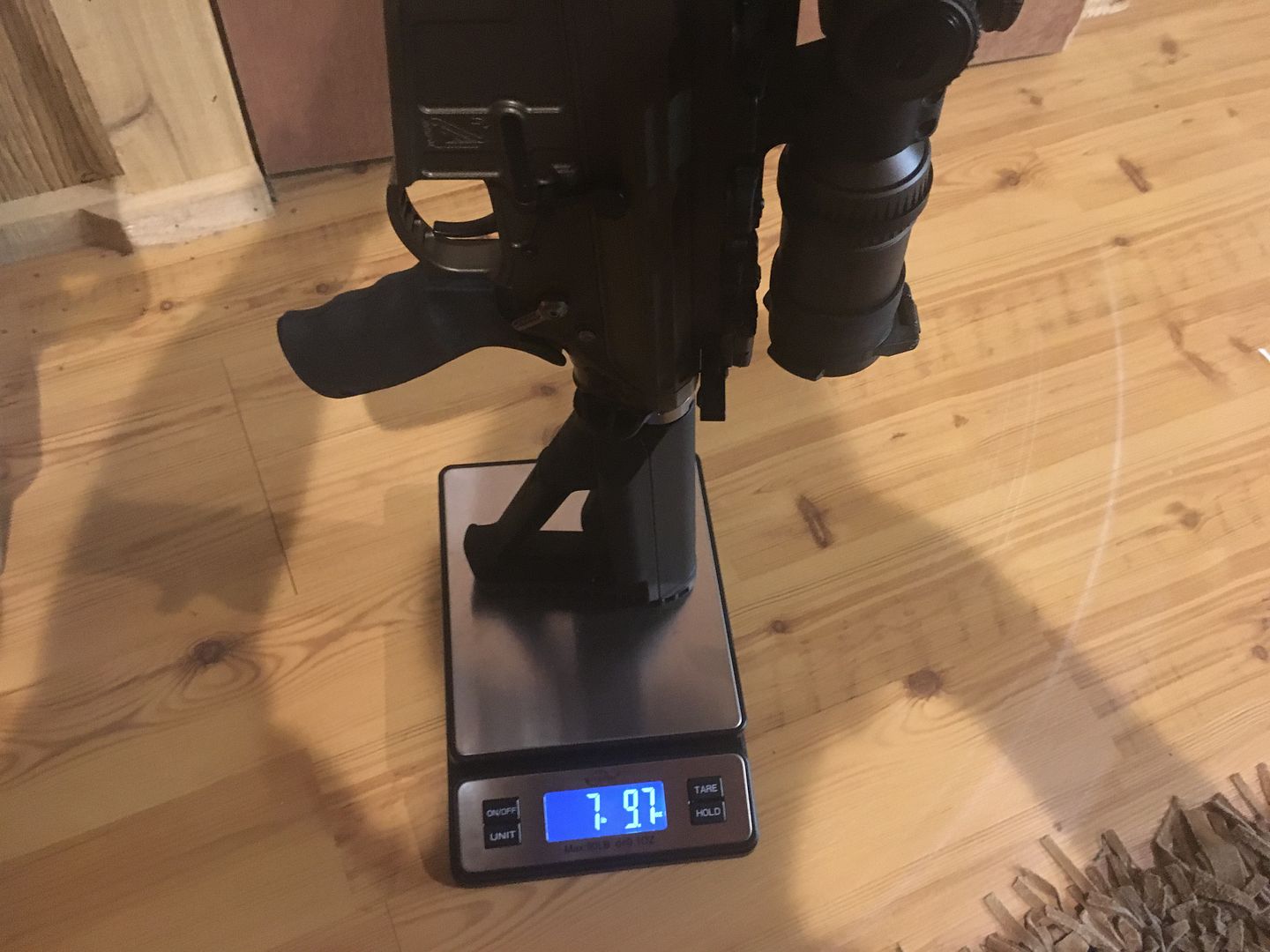

Built some fine shooting ARs. Usually hbar. But you would want a gunbearer if you got far from the bench with one. Bought.an upper from Robert Whitley. 6mm AR with a 26" krieger barrel. That.gun would often shoot quarter inch groups.
Got.away from that. Built a grendel with a JP 18" lightweight barrel. I wouldn't call it a half inch gun but a respectable 3/4" gun. And that is with factory hornady SSTs. Haven't even bothered to reload for.it. it is my hog hunting gun. Only time it has been on the bench was sighting in. It is a little over 7.5# with optics. Fun hog gun. We try to kill all we can. Multiple shots are the norm. Had a friend who started with a .308 AR10. He quickly gave that up after a few nights of lugging that thing around.
