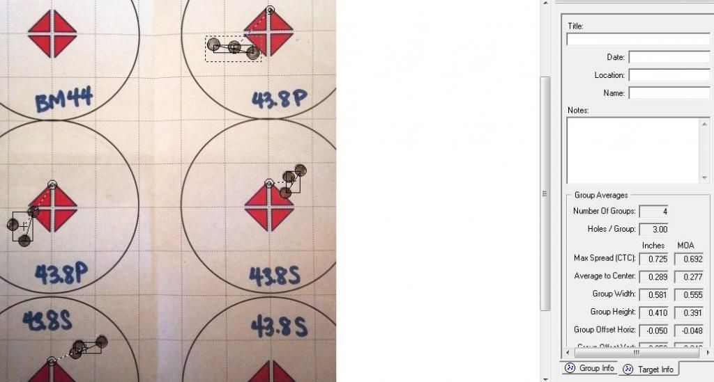

my LR-308 is shooting sub-3/4" groups.
JP stainless barrel, BCG, bolt
bipod and rear bag
175gr SMKs or M118LR pulled 175s w/ 43.8gr Varget loaded to mag length 2.800"
