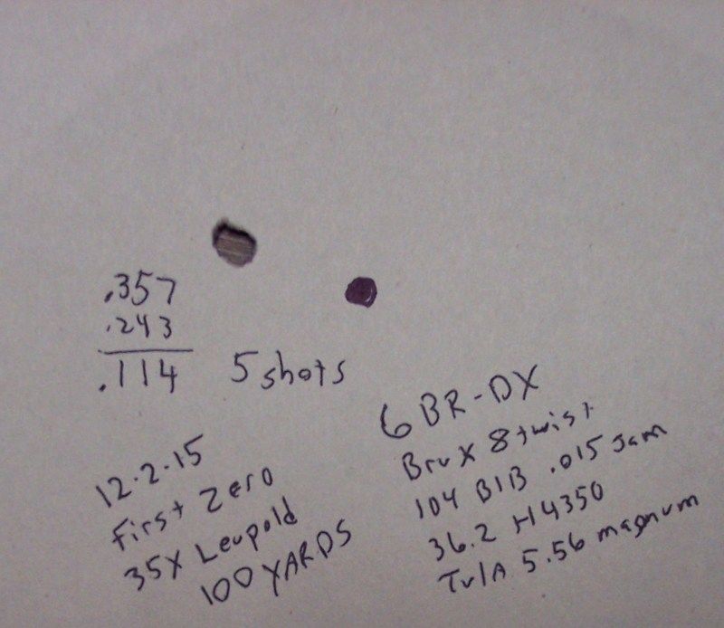

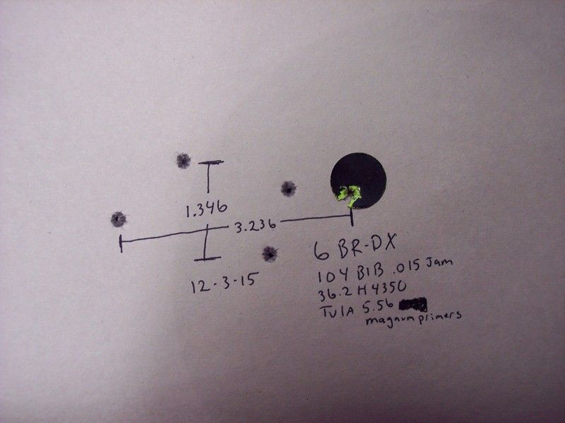

first pic is getting a zero at 100 with the 35X LCS I had just bought,,2nd pic is first 5 at 600 with 35XLCS the next day

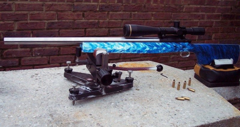

3rd pic is rifle,,Stiller tac 30 action with custom contour Brux 8 twist bbl by Tim Claunch and the ST1000-F stock I bedded myself with a SS follower so I can take bbl/action out of Tracker and follower stays stuck to the stock and I can but bbl/action in the AICS 1.5 and shoot as repeater,,
I bought 1500 of the 104s from the ads here at AS and have about 800 left I am saving with the Brux bbl for Bluegrass Balloon Bust
