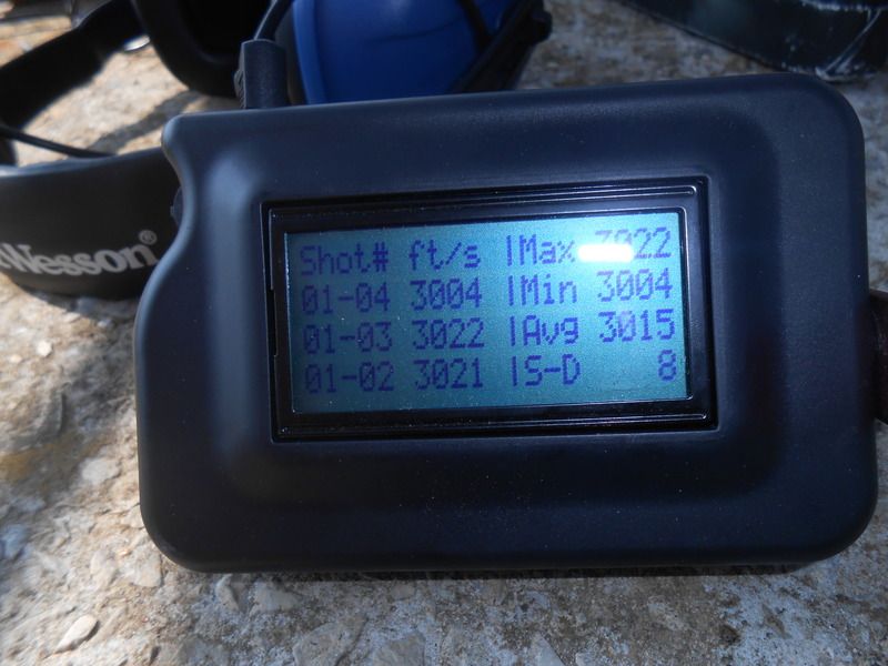

Went back to the range yesterday to try another powder charge increase with H4350 and 105vld's. Started at 36.2 and went up in 0.1 increments. Got up to 36.5gr and ran out of room in the case. Shot two 3 shot groups at 36.5gr which averaged 0.18moa. Again, did not run into any pressure signs. Will borrow a chrono next and see where we are velocity wise.
Dave

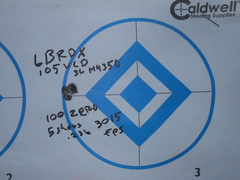

shot this morning and decided to go with 36 H4350 in my BRDX and 105 VLD,,shooting in the .600s at 300 yards,,,eggs are a gimmie
checked zero at 100
