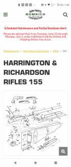

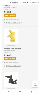

Actually figured out a way to get that trigger down without a tone if work. You can order a rebounding trigger for a H&R 155 I think from numeric gun parts. Gets rid of the transfer bar makes it easy to get a light trigger with a little file work and lubbing.only thing is you gotta streach your original hammer spring out some or find a replacement at the hardWare store . The deal is your gonna have a half cock deal like the old guns but I don't mind too much
