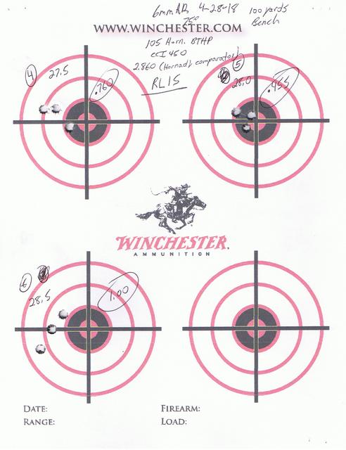

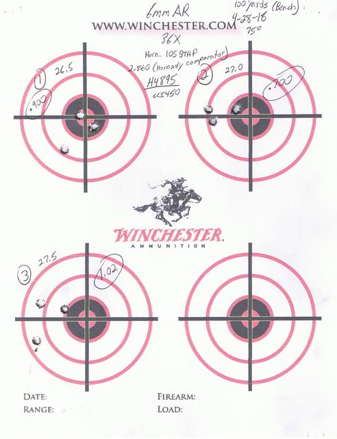

I recently started loading for this round and would like to see the data that you guys are using. I've gotten all the info I can from the available online sources including the great article on this site, the load data at 6mmAR.com and what little there is at the Grendel site but would like to expand my "personal load manual" so to speak.

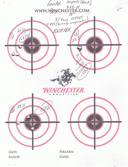

If anyone else is interested here's some of the test results that I've gotten from my Saberco 26" Upper......the good, the bad and the ugly......

i would stick with h4895 and a 105 berger hybrid. find your pressure point. if you can get to 28 grs might be a node there. then play with seating depth. single load start with jam and work out in .005 increments. mag length start at max and work back in .005 increments
mine shoots pretty good
My fatrat loves CFE223. H4895 was too hot of a load and it would blow the primers and trash the brass. Pick your powder and start out low and check for pressure signs. Average speeds should be from 2500 to 2850 depending on your bullet weight. My 20” barrel is right at 2650 fps and my 28” barrel is at 2750 fps.

reloader 15 would be my first choice to try... my 6.5 grendel loves it. about 103% fill... is what it is.. no pressure signs.. drives tacks.. With the smaller bore you wouldnt have to fill the case as much. just gotta try a work up..

I have done a little testing with RL15 and it was very promising. I was hoping that one of the powders that I already had large quantities of would work.....but darn it....another 8 lb jug of something different might just be what I need....and the RL15 shot well enough to be in the running for a whole keg to grace my shelves.

Saberco upper w/26" Bartlein. Berger 105gr, 27.9 through 28.1gr N140 all produced 0.5" to 0.6" 5-shot groups. Average MVs were 2655-2667fps.
For me, RE-15 was not as good and certainly was fussier about the load.

8208 was giving me great groups with the 95SMK and Berger 95 VLD Target bullets as well as Hornady 87gr BTHP, H4895 while not as forgiving as the 8208 the velocity was awesome BUT missing 150fps faster than something you will have a better chance hitting slower I think ya get where I'm going lol I've yet to try RL15 but that's on my list of to do's and I'm hopeful as I use several pounds of RL15 in other calibers I have so it would be great to narrow down the powder canisters on the shelf but as said above I have heard it can be finicky in this caliber.

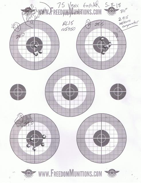

75 grain Vmax test.....I am really looking for a long range varmint load with a heavier bullets but am not leaving any stone un-turned....The gentleman that sold me the upper mentioned that it shot the 75 Vmax well so I had to give it a shot....Well it looks pretty good during the early stages of testing....We shall see how it holds up with 10 shot groups and longer ranges.......Here's the results of my 5 shot groups from this afternoon:

What range of charge weight did you use for 8208 and the 95 SMK's? I have a fat rat, and i'm having a hard time with the 95SMK/H4895 combo. Is yours a 6mmAR or the Turbo?
