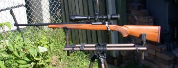

I understand the attraction for the many different 20 cal rounds. Still, 204 Ruger is a fine little cartridge. The accuracy I have seen shooting my Ruger M77 Hawkeye in 204 Ruger (shooting inexpensive Fiocchi factory ammunition) so impressed me that I sold my CZ 527 (223 Rem.) during my latest purge of my gun safe. At any distance out to 300 yards, I get better accuracy with the 204 Ruger rifle than I ever got with the CZ in .223 Rem.
Oh and by the way, I bought the Ruger M77 Hawkeye simply because it was the only left handed rifle I could find at the time that came in 204 Ruger. No other reason. It was a risk that worked out fine.
I have loaded up a few rounds to try out. I loaded using basic middle of the road suggestions in my Lyman manual, so I still have a lot of work to do, to find the load that shoots best in my rifle.
Here is that rifle:

I like the Hawkeye rifle. Just seems more solid and ummmmm, 77ish than the American.
And of course the 204 is a fine cartridge. Probably the one that got the whole 20 cal thing rolling. Of course most of us who reload, would choose one of the other 20's just because of the brass thing. And since you're loading for your 204, you will be able to really hit it's potential with different bullets and powders than factory loads provide. jd
