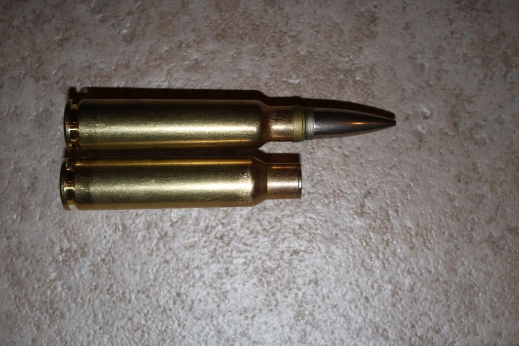

7.5x55. The Swiss have been using it for decades.
[br]
In fact, 101 years. I have both a 1911 Schmidt-Rubin and a K31. Both use the GP 11 cartridge adopted in 1911. Except for the slightly large case head, DukeDuke is dead on. The two cartridges are very close.
I'm sure I am missing something but what is the relationship beween the Swiss case and the 284 case???
[br]
Body diameter, case length and capacity are very close. The GP 11 has a shoulder angle of 31° vs. 35° on the .284. Years ago, some folks ran Winchester .284 brass into 7.5 X 55 sizing dies after expanding and shot that instead of the expensive Norma brass.
