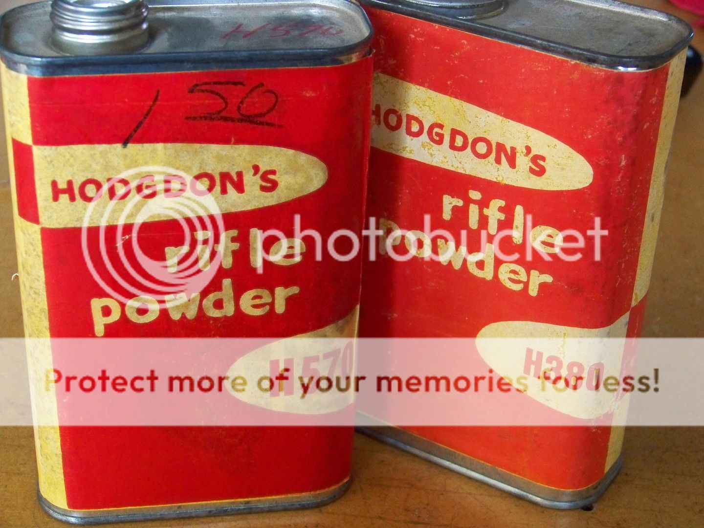

I've got I think, four cans of OLD H380 that I've never used for anything. Cans are still sealed at the cap. One that isn't still smells good. I was wondering about 22BR?? jd
Anybody else notice the price? Talk about inflation devaluing the dollar!!!
I remember buying all my reloading supplies in the early 70's at the Rod and Gun Club on Base. Still have a few of those old cans, empty, but the price is still clearly marked 1.95. Let's see, my 72 Olds Cutlass was 3250.00 in 72, in 2016, er, no more Oldsmobiles.
Back in those days, you could buy a couple of boxes of factory shells (40 rounds) for around ten bucks. Or -- you could buy ten bucks worth of reloading components, and load a hundred shells, and still have some powder left. jd

H-570 was the only powder listed and used at Williamsport for the 7-300 weatherby . I still have a couple of pounds , which goes fast in that case .
