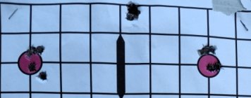

If you're shooting factory ammo and want to keep using the same after speedup, AND assuming your groups open up, you might try something like an ATS tuner (slimline) to pull those groups back in. Here's an example, bottom two groups are after speedup that before speed up were printing one ragged 5 shot hole. Pretty obvious how much they opened up. Top-center group is with a slight tuner change. You can see it pulled it right back in. One lot of ammo all I had to do was screw the tuner on and it pulled in while still set to zero. The other lot I moved it 3 marks to get it back to one ragged hole. All my groups before speed up were like the top center one. I actually didn't do this test to fix the factory ammo, my loads of 143 eld-x did the same so I simply used the tuner to eliminate away from the variables and assure the opening up was due to speed up and not a scope or other issue. Since changing the harmonics (tuner) fixed the issue on those as well as factory, I reduced my loads a little so my speed was the same and my handloads were back to one ragged hole without the tuner. I recorded the tuner settings for each lot of factory ammo so if I'm shooting that it's not a shotgun pattern ;-)
below is Norma 143gr target ammo (all same lot, post speedup, bottom two no tuner, top tuned)
