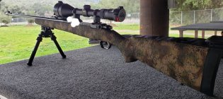

Have a ruger m77 mk11 7mm mag just started shooting it. Sat unfired since the 90s. Took the nice wood stock off so it would not get beat up hunting with it. Put it in a hs precision stock . Shoots lights out cant complain probably shoots as good and better than full custom rifles. Still has the factory trigger heavy pull weight. But it breaks clean. This is my experience with them and its only a small sample size.Screenshot_20220907-111641_Chrome.jpg Screenshot_20220907-102554_Chrome.jpg
