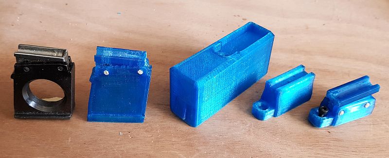

Hi guys, that’s me (Concorde aka Panther) sharing the 3D print stuff that I designed for my own Vudoo and Anschutz. Thanks for the nice comments!
It’s unfortunate that Vudoo stopped making a single shot adapter for their repeaters after they came out with their V22S rifles, but that’s why I designed and created one for my own use, and now make them for other Vudoo folks. There were enough “referrals” like from this forum of people who aren’t on SnipersHide, that I’ve also now got them as a recurring listing on eBay (eBay ID mike*c).
I took one for my Ruger precision 6.5 Creedmoor and reverse engineered it and milled a couple out on the CNC mill from that model. Works great.
I can totally vouch for Panther over on SH (even though his feedback speaks volumes on its own), he’s a super good guy to work with and ships crazy fast. I ordered a single shot for my Bergara B14R and now I need to order one for my VUdoo as well.

Hi,
That's my first post, sorry to have skipped presentation.
But, single shot was a concern for me and all my CRF 22 (Brno, CZ, Anschutz, Bergara)
My main concern with "simple" single shot adapter is that we lost the controlled feed dynamic, rim gently positionned behind extractors and cartridge introduced straight in the chamber.

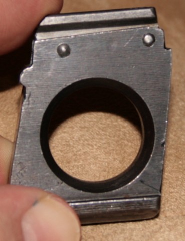

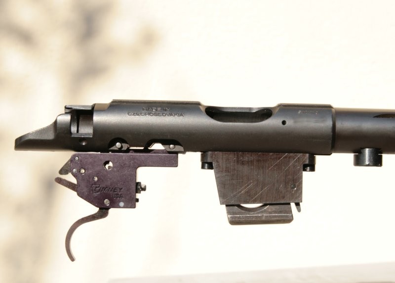

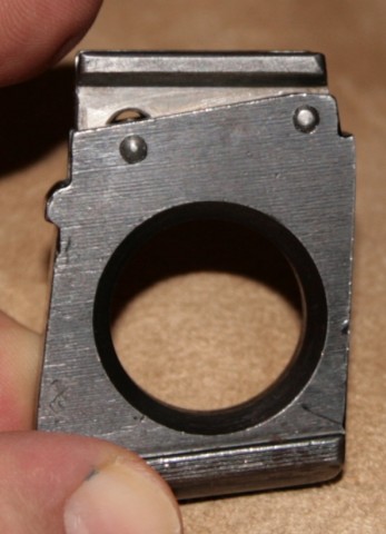

Years ago I had a BRNO (CZ ancestor) with a great piece of single shot adaptor used for ISSF match.
Spring loaded bucket
No need to feedle with the cartridge, just drop it in the bucket.
At first for the fun, I decided to make a replica for a modern CZ 457 and it works.
I own a Bergara B14R which is a CRF too. At first I made a simple single shot adapter, works but not completly satisfying.
Then I made a mix with AICS 22lr magazine and the old BRNO single shot.
Spring loaded bucket to keep advantage of CRF.
Need to be refined but it's already working.
I think that it could be (easily) adapted to Voodo action and RimX, but I can't test to confirm.

From solid BRNO to printed AICS
At first I worked the body, as printing this big part is time consuming. I designed it with a slot to be able to work on the adaptator part without the need to reprint the whole magazine.
I had to made some iterations redesign/print, even on the "simple" adaptor, to get a good fit and working part. But with the approach it wasn't too painfull.
