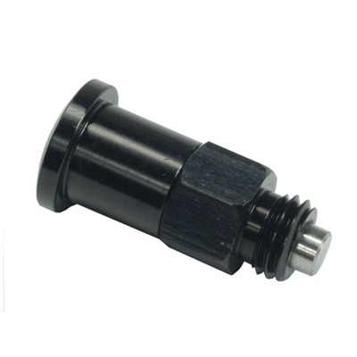

A friend of mine acquired an R700 with one of those obnoxious Sinclair plunger style bolt-stop/release mechanisms. He asked if there was anything I could do to replace it with something that didn't look like a mini kill-switch on the side of his action. I see from Sinclair's ad that these use a 5/16x24 thread so a 0.250 Defiance style won't cover the hole. I suppose I could plug-weld it with TIG or solder or locktite a bolt piece, but looking for something cleaner or more elegant.
