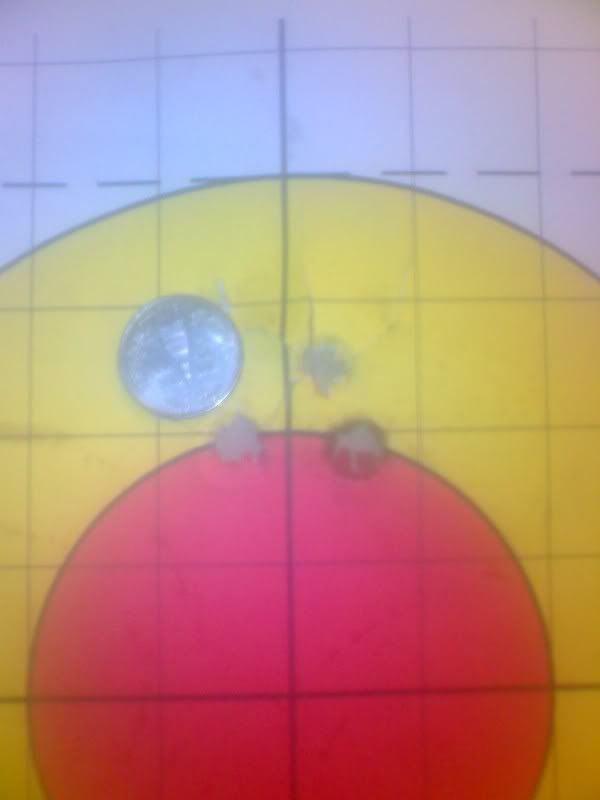

Ducks and Bucks,
I have the same muzzle loader as you. I use Blackhorn 209 and Federal 209 shotgun primers. My load is using Barnes 290gr TEZ, and 73.5grs by weight ( 105 by volume). I even tested the load with a Chrony and with three shots it averaged 1890 fps.
In my area we have to hunt open sights ( no scopes allowed). Took a deer at 152 yards, hit high shoulder and ended hitting the spine. Dropped like a sack of potatoes.
100 yard target:
