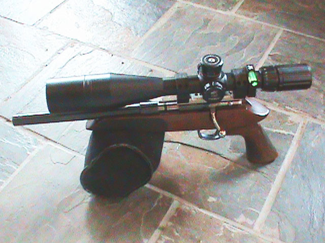

Last year I made a billet aluminum stock for my Anschutz Exemplar. Not the most cosmetically pleasing stock ever created but it really made the Exemplar a lot easier to shoot at our local longrange rimfire matches using bipods or bags off a bench and compete against the rifle guys.
There are a lot of the Exemplars still out there and with IHMSA silhouette about dead these guns haven't seen much use. The original wooden stock just wasn't designed for use off a bench but shooting creedmore is really shined.

The stock should fit both models, I think the stocks are the same, if they are slightly different then a slight change in the code should be all it'll need. Joe mentioned that the width would probably be narrower than mine at the rear. More like the stocks he's making for the centerfire models. If a benchrest shooter needs a wider forend then a wider plate to slide in the bag could be easily added to the bottom. It would probably be about an inch longer in the front than my original stock. That is all the longer my chunk of aluminum was and I had to make do. Adding a bipod to the front I had to move it forward a bit more than I thought, both the Harris and Sinclair pod-loc were in the way of the magazine coming out. I moved the mounting stud out a bit further to let it clean and that helped.
