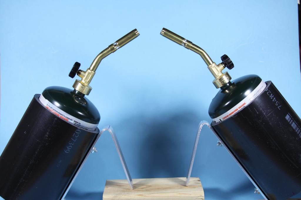

I was impressed enough that I shamelessly copied it. I like the two torch setup to use with my cordless drill. Annealed 223 brass in less than 3 seconds. I used it for a few years before I broke down and bought an automated machine. But I had annealed thousands on mine before I upgraded. I had the PVC pipe and aluminum strap on hand, so I just spent $$ on the torches. I had less than $25 in mine.
[URL=http://s860.photobucket.com/user/jepp2/media/TorchHolders_zpsd9c72c42.jpg.html][/URL]

Saw this.. I can't justify a $250-$400 anealer. i just wouldn't use it that much. Found this and looks interesting.. Anyone using one??
http://www.cartridgeanneal.com/
I own and use a BenchSource but you are not asking about that. The machine you are looking for feedback on is indeed better in some ways than a drill and socket (which I too have used). I will list it’s pros and cons here:
Pros
  1. You don’t have to worry about getting a consistent distance between your brass and the flame, the holder will make sure this happens - this is important.
  2. You have two torches which mean both sides of the neck gets heated.
  3. You don’t have to worry about aiming the torch in a consistent area of the case, again the holder will help you do that - this too is important.
Cons
  1. Your case is not spinning and so even when you have two torches, this may not give you as much consistency as you may want.
  2. Your turn off switch is your finger. The problem here is that means the resolution of your annealing time is probably not as good as you need it to be for a machine anneal which is more like 1/5 of a second. In my hands using a machine a 1/5 of a second can make a significant difference.
Just looking at this thing, it is really a simple device with some good ideas. If you really like it, buy it if you have the funds or just make one – it would probably take you a few hours at most if you are handy.
