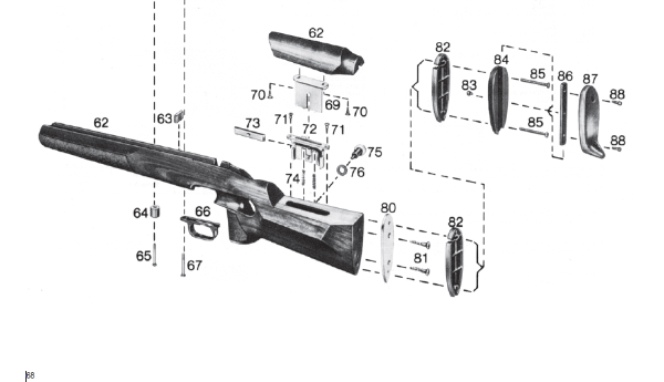

To mirror my reply on RFC. You have an 1808 Stock. Yes, it's newer than the barrel action, which appears to be a modified 1607 made in 1978. The 1808 was Anschutz's dedicated 50m Running Target Rifle: https://en.m.wikipedia.org/wiki/50_meter_running_target
This 1808 variant was based on a 1907 ISU Standard. However, Anschutz changed the shape of the fore-end to suit the sporting-style hold used in RT, tweaked the grip, and scooped out the butt. I'd guess this was made in the later '90s or early 2000s. I do wonder why Anschutz didn't update the model no to 1908.
You appear to have an 1808 ED Super or EDS barreled action with an 1808 D-RT stock. The stocks on the two models are somewhat similar but different. For example, the latter has the cut-out butt stock that's shown in your pictures.
From the relevant Anschutz manuals for below is the D-RT stock. Next is the EDS stock.
