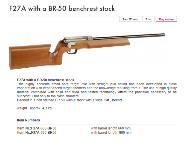

Is the 1727 action available in a benchrest configuration? In other words, a conventional BR stock, not a chassis.

As noted above, there is a benchrest version of the F27A single shot Fortner action. When it was available, no doubt in small numbers, apparently there was a choice between two barrels, a 660mm and 690mm. (These are the lengths available on other Anschutz match 54 single shot rifles.)

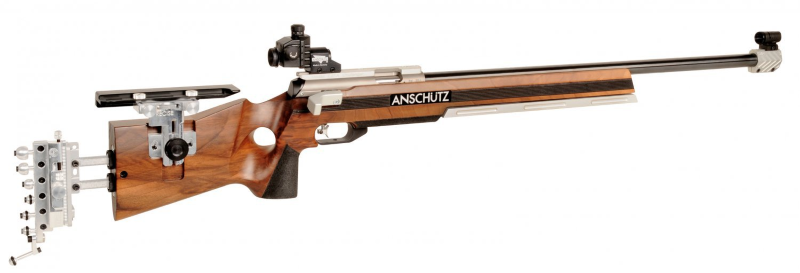

It seems it was also available with the AS-300 Thumbhole Benchrest stock, not often seen in North America. This stock was originally designed for round action 14xx, 18xx, 19xx, and 54.30 barreled actions.
The AS-300 stock shown separately below with different butt stock hardware.
