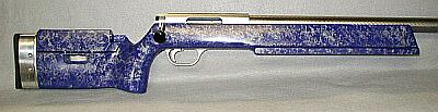

Gray Stock, Middle of the page, Says Master 1000 on the front, being held by Dianne Hoover.
Also at end of article is a Blue version:
More Pix: http://www.masterclassstocks.com
