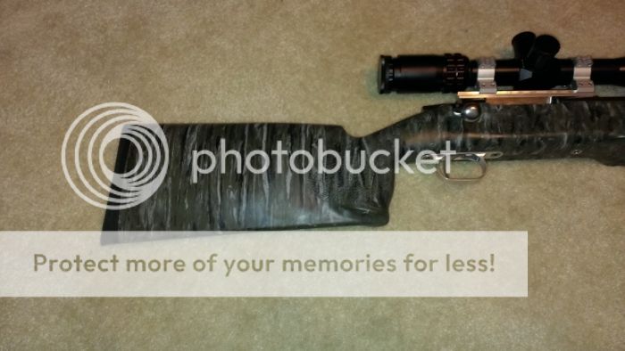

Well...I know this is an old thread of mine. But today I finally picked up my new rifle. I'll see if can post a pic tomorrow. It's a Bat action, Kreiger 4 groove 8 twist 28"(2 barrels...one for 95gr and one for the 105's), Tooley MBR stock, jewel trigger, and a 15x55 Nightforce with Sheehan rings. All smithed by Sid Goodling. Can't wait for the weather to clear to try it out.
Guaranteed that if you stick with 105 Scenars, Hybrids OR 108's you will be shocked (nicely) at how excellent it is going to shoot!!
Well...It was going to be a Rem...but thought about it for awhile and decided to go full custom...here's a couple pics...not the best pics but...The was supposed to be 50% olive drap-25% grey- 25% black. It's alright...seems like a lot more than the 25% I was looking for.
Primary use is matches...local g-hog out to 500 yrs. Then some 600 and 1000 once I figure it's best load. I had a 6x47 lapua but could never get it to shoot consistently at 600. I should have kept that rifle, but didn't think I was going to compete again. Now I have that craving again and in the right frame of mind.
