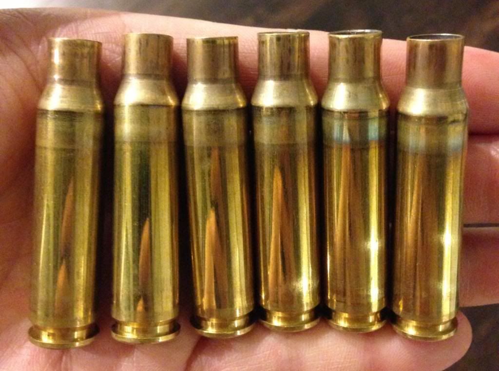

I had tried a different time with lapua brass and here are the result
Anneal with Butane Torch
1-4 from left were anneal for 6 sec.
5-6 from left were anneal for 8 sec.
In dark room, It seem like the case nk was start to glow orange at 8 sec. So, is it too heat for that?

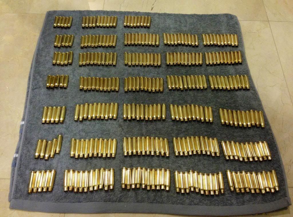

My volume was around 200 - 300 pcs per time.

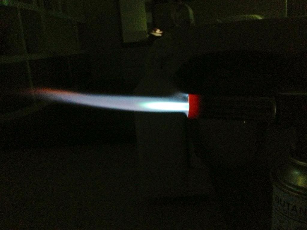

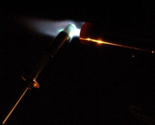

This is my heating level
Hold with 1/2" bolt and rotated by electronic screwdriver.
Do I need to reduce gas? How long of inner fire is proper for anneal .308 win brass?
The current inner blue tip was around 1" from Torch.
With your setup, based on the pix that you provided, 6 secs does not look like enough. 8 secs looks good.
One inch blue flame is fine. Mine is about 3/4 inch and I do 8 secs on 308/6mm brass.

Butane's not propane (pretty close though, close enough for annealing case necks) but from your pics it looks like 8 sec. works to about the same result as what I get.
My only suggestion is move the case necks out a little bit. You want them just at the tip of that inner blue flame, that's the point with highest flame temp. Closer in & you're in a fuel/air mixture that's a little cooler.
A little glow seen in a darkened room is OK. For safety reasons I prefer annealing in a well-lighted workspace. Early on when I was climbing the learning curve I used Tempilaq as an indicator, also tried a few in the dark. Ended up deciding dwell time & reasonably consistent flame appearance were reliable enough for my needs. Now my brass resizes far more consistently than before & I haven't had a split neck in years.
