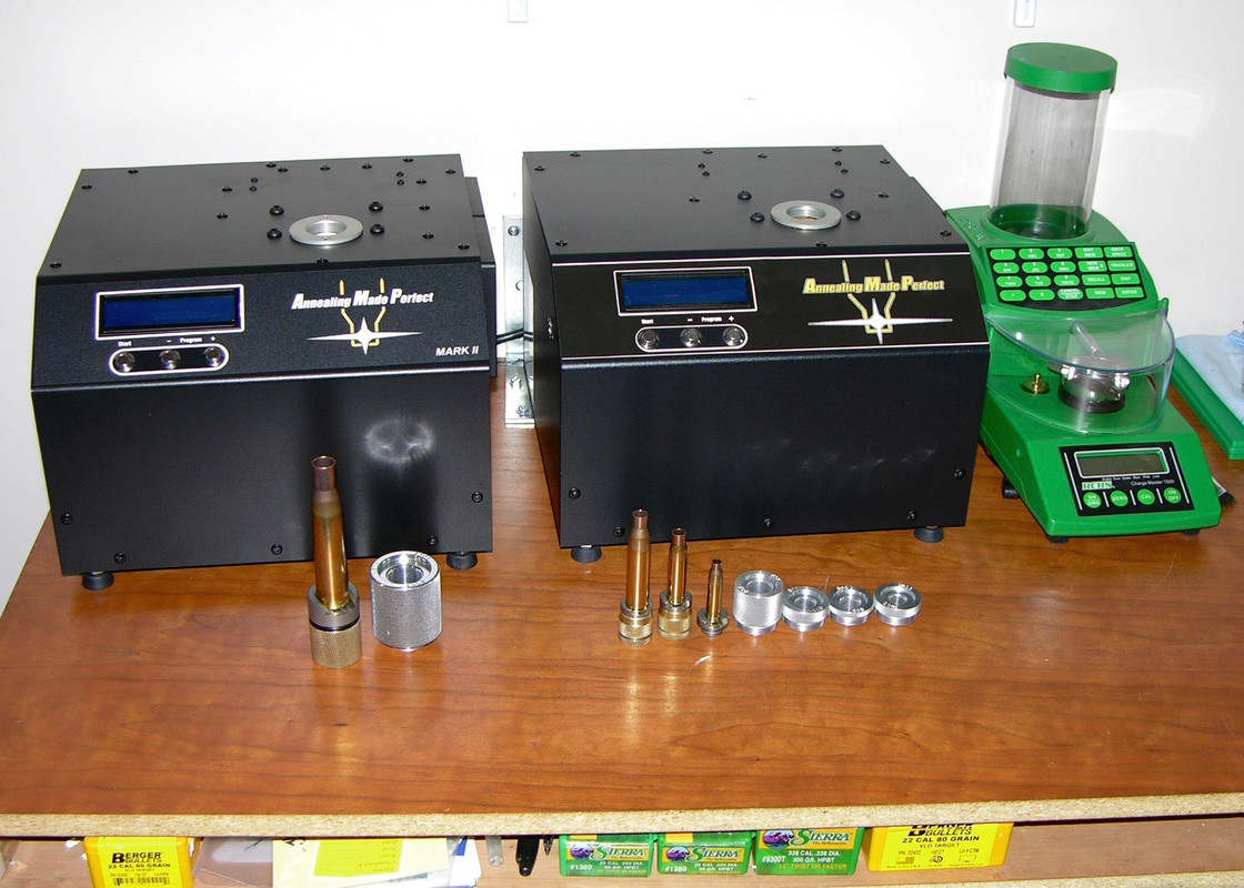

Finally got to try it out yesterday. (Life just got in the way since last Thursday.) The Aztec mode is cool! It seems the factory setting for Lapua brass is spot on. I tried it on four different calibres (all Lapua). This thing is really just plug 'n play. Having the original unit since the beginning of this year, there was nothing different to learn in the standard mode. (btw, I did use AMP's case evaluation service earlier this year before the Aztec software upgrade was available on the original unit)
Above, it sits next to the original machine (on the left). As you can see, the cabinet is exactly the same. But there are dual cooling fans instead of the single one on the original unit. Have a look at the size of the BMG pilot and grip/shell holder. Massive compared to even the .338LM which sits on the left of the smaller line-up. But, isn't everything with the BMG?
If you're still on the fence about these units, really....they are so easy. Pricey? Yes! But the cool factor is off the charts! So what's to report? It looks like same old, same old as compared to the original unit. With the exception of doing the BMG case and having the ability to evaluate your own brass. Choose your program number, correct pilot, and grip/shell holder combo....insert and push the button. Make sure you have a cooling tray (don't drop a hot case on the carpet), and away you go.
Will you do me a favor and look into pilot hole and tell us if the plastic cradle under the induction coil of your first unit has been removed in the redesign of your new machine. Enjoy the new unit.
Yes it has been removed. There is no cup there. There is a longer ceramic insulator with a hole in the bottom. The white color tells me it is ceramic. The original machine's pan is polycarbonate (plastic).
