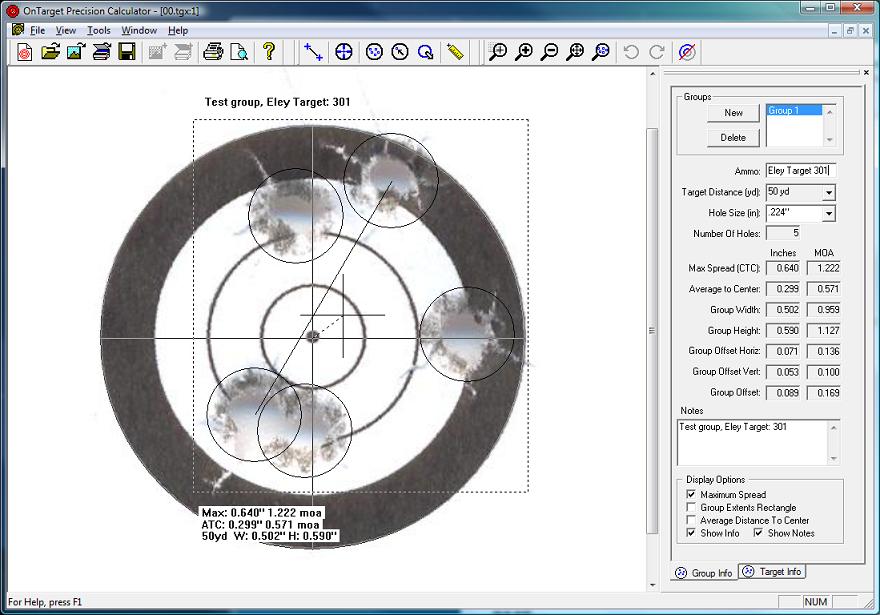

Use On Target software.
Get it HERE: https://ontargetshooting.com/
Just place the circles around each shot. Then the program will automatically calculate group size, measurement in MOA or mils, and distance to aimpoint.
I have tested On Target results against actual certified measurements, and it is normally accurate within about three hundredths of an inch (.03"). That is still more accurate than most measurements, particularly on the internet, where guys typically fib by a tenth or more.

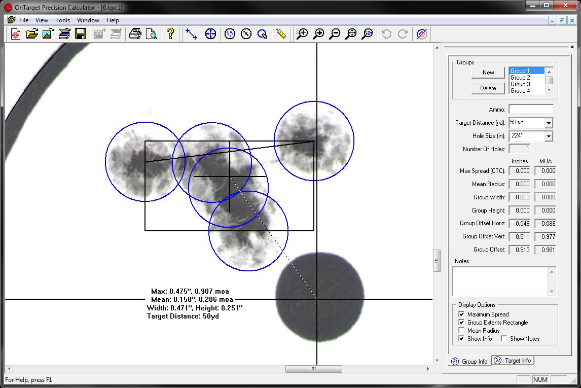

After reading this thread, I decided to download OnTarget DS version 6.9. Took one of my targets and scanned it in. Directions are scarce but I managed to get it to partially work for me. I could not find a way to print the target along with the data so I just printed both out and cut and pasted it together.
The question is what do all this data mean to me. I am old and don't cotton to new ideas easily.2019-04-26_170147 copy2.jpg
Can one of you explain what the data in my last post is telling me? I am unable to find the definitions for the abbreviations in this program which is why I posted it.
