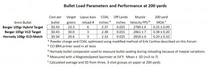

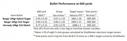

There have been shortages of Berger 6mm 105gr hybrid target bullets which I shoot in my slung 6BR match rifle with a 1:8 twist barrel. I am looking for alternate bullets that will give me comparable accuracy at 600 yards.
So far, I have tested Berger 105gr VLD target bullets and Hornady 108gr ELD-Match bullets. Load and performance data are below, and the VLD’s appear to offer the closest comparable performance.
Are there other bullets that I should consider for a 1:8 twist 6BR barrel shot at 600 yards?
Thank you in advance for suggestions and comments.
Load and Performance Data at 200 yards (corrected table):
Performance Data at 600 yards:

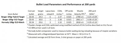

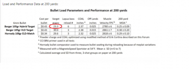

Load and Performance Data at 200 yards:
is that 23.3gr Varget in a 6BR correct?
