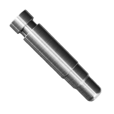

I was browsing reloading dies on eBay and noticed this powder funnel for the Dillon. a bit pricey imo but seems to be an adoption of the Lyman "M" die.

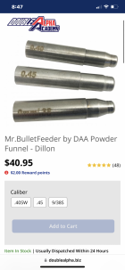

I use something similar. They are made by Double Alpha mr Bulletfeeder. I used to obsess over pistol accuracy. Constantly testing in a ransom rest. These are good to go. Problem is they are only available in a few calibers.
I am a big fan of the Lyman "M" Die and use them for loading rifle cartridges and are real handy loading flat based bullets. The nice part is you can place the bullet relatively straight in the end of the case without it falling out, compared to the traditional flare.
I used to use the Mr. Bulletfeeder. Now I use this one:
It is smoother and provides better setup especially when loading on an auto drive.
