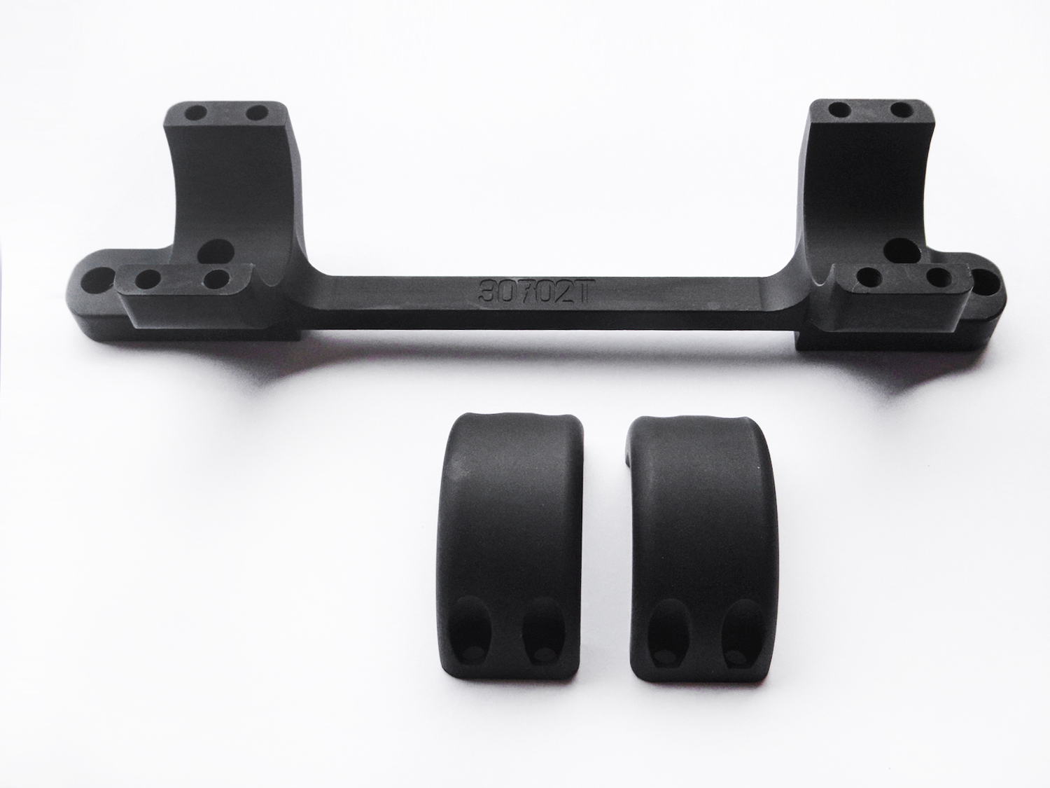

I'm not sure what the consensus is on them here, but I like the DNZ Game Reaper 1 pc mount.
