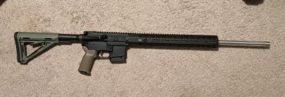

What you are talking about doing is what I did for my PD hunt. Aero uppers, one new, one off another set up neither M4E1 enhanced, just standard receiver. Shilen HV match 24”, which they had in stock and it came with a headspaced bolt. These were shot with factory 55gr rounds during the break in. Somewhere between 40-50 rounds down the pipe.

Just finished the gas block tonight. That was a struggle, had use to 4 hands, the roll pin was a bit tight. Other than the roll pin gas tube the upper was EZ.
Yes that m4e1 enhanced looked to be the strongest upper due to the way its engineered with the monolithic type extension and stout barrel nut with threads on the outside.
I had read some of the bull barrels would not fit with a standard AR barrel nut handgaurd. People had issues with the barrel I bought but E. Aurthor fixed it so it works with any AR barrel nut handgaurd.
The barrel fit perfectly and M4 feed ramps alinged no slop at all. The Gas block aligned perfectly with the hole and barrel divot. The tube and gas key on the bcg perfect. I'm pinching myself because usually you run into some kind of issue.
I thought about getting an adjustable gas block (I can add one easy) But I went cheap with standard aero low profile for like 28.00 vs 105.
Next step is to shoot it. Maybe this weekend.
