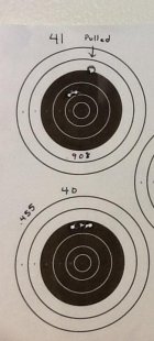

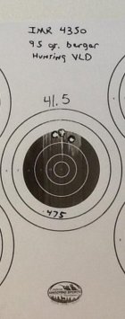

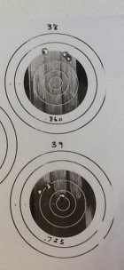

These were from my model seven predator in .243 with 22" barrel. Shot at 100 yards off bags
loads were imr 4350 and cci primer with 95 gr. Berger hunting VLD and new remington brass.
Which if any groups do you guys think I should use?

41,41.5 look pretty good. I would start playing with seating depth now.
That's what I was thinking I will load some 41 and 41.5 with varying seating depths and see if I can tighten them up
Maybe its just the way I see the pictures, but the holes do not look symmetrical and large (stability) to me ?
What twist barrel ?

If it were myself I would go back again starting at 39.5 due to the fact you say the 40 was pulled but yet not re-tested, I would also try using a brighter aim point that has definitive horizontal lines to determine if you're canting the rifle...
If the targets shown were the backer targets then the only question i would have is what would 40 have looked like had it not been "pulled".
Certainly some potential there though.
Maybe I'm all wet here, but I see stability issue.....
I suggest to shoot a couple at both 25 and 50-yards to check for stability.
Be square and parallel to the target and use a card stock type paper.
You want the bullets to print total symmetrical cuts, under caliber in hole size (like say .200" holes with fractures to .243).
Donovan
Donovan is likely right. That bullet is a little on the marginal stability side. Check the factor at Berger's site against your muzzle velocity and conditions. [br]

The 95 vld has a very short bearing surface. I don't think you went high enough with your charge. Looked to me like it was just starting to tighten up. Try working up to 42.5 if you havnt seen pressure signs.
40.0 looks the best. Watch the wind [use some flags] and they'll start piling up on top of each other. Some were shot in a push, others in a letup. :)
The first 5 groups I shot were 43,43.5,44,44.5 with no pressure signs but the groups were around
2" to 2.5" with the exception of 43.5 it was around an inch. So as already stated 42-42.5 may be
worth a try. I really appreciate all your guy good advice :)
My advice on the groups is to lose the black targets. Great for ironsite bullseye match's, and match's where spotters are working the pits, pulling and scoring targets. Not so great for precision shooting with scopes. Even the IBS 1000 yard targets are not black.
All you need is white or buff colored target paper with a day-glo orange aiming dot to get the job done.
You also did not say how many shots were fired in each group. Was it 3, 4 or 5 ? Difficult to tell in the black background.
