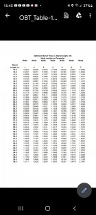

Are you using optimal barrel time to get you close to your node window.

Here is a obt chart if you would like to try it...
