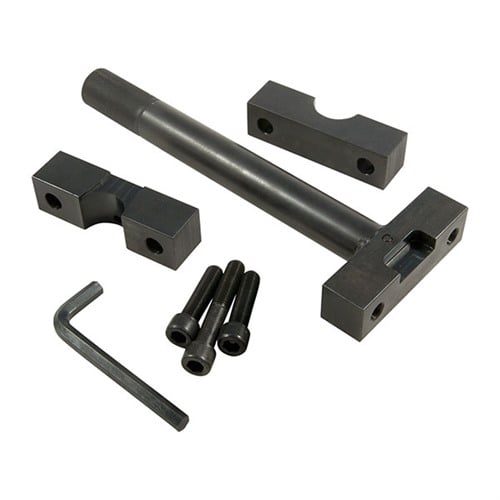

Been looking to buy a wrench for a farley.
will any Remington 700 footprint wrenches work..
Thanks in advance
No. The race ways are too narrow.
You could take a Remington and mill it to fit.
Another option is the big Brownells wrench that clamps around the reliever ring. The diameter is close enough to the Remington.

Ok will a action wrench for the Farley black widow action work?
