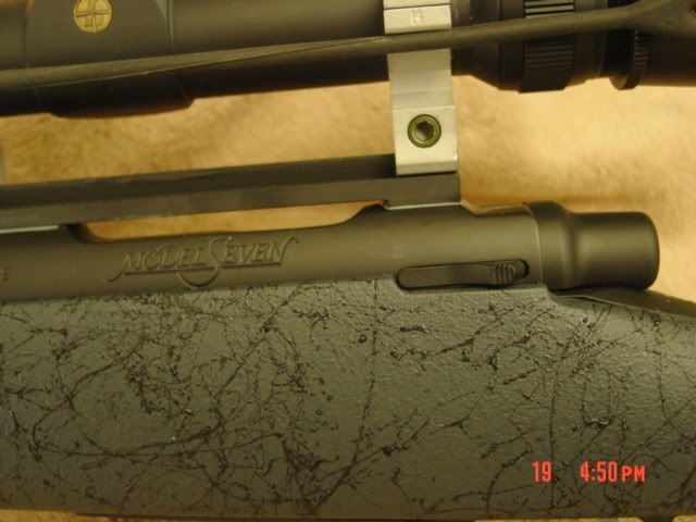

I have limited experince with baked on coatings at home,KG gun kote and parkerizing zinc and mang). While I have not used Duracoat its like an epoxy and is thicker than Gun Kote. Gun Kote seems to hold up better than Durcacoat,assuming you prep the surface, I think fresh parkerizing works better than the k-phos treatment KG sells but others claim the k-phos is great). Duracoat comes in many colors and works better on stocks but Gun Kote seems to be a better metal finish.
Go to www.riflestockpainting.com Charlie is too cheap and does a wonderful job.
Charlie did both the stock and metal and I think both were in the $200 area. He has a quick turnaround also.
