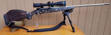

I built a number of 257 Roberts Ackley rifles in 2002, and thought "no more Ackley chambers. Forming brass is too much trouble."
But in 2018, I built a 280AI and loaded ammo with Nosler 280AI factory brass.
It worked well and now I have a number of 280ai rifles.
Love the old model 70. What barrel is that?
I had a very similar rifle built for my wife in 280AI. Pre 64 action, Brux barrel, McMillan stock.
I did not have good luck with the Nosler brass though. I fireformed some decades old Remington brass that seems like it may last forever.
1949 Win M70 280AI Bartlein barrel, McMillan stock
1" (3) shot group @ 200y on sight in 10-1-2018
Later that month I got a buck.
