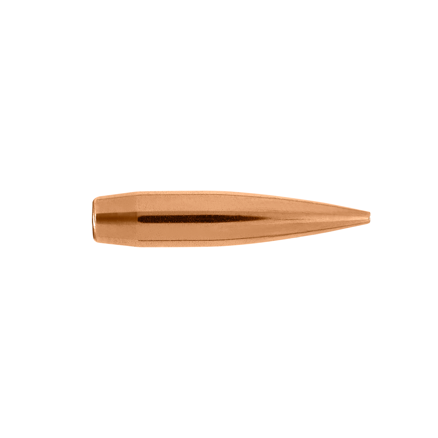

It is often difficult to guess what is available in Oz, but something along the lines of a Sierra Match King Bullet from 168 to 180 should be the best bet. You are also likely to find the Berger equivalent match bullet lines with their 185 Juggernaught or maybe the Lapua with Scenars?
