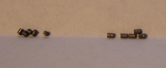

That didn't sound right to me, so I compared AA vs. H 4350. They are both single base powders in a very similar energy and burning rate range. It may be that Hodgdon applies additional coatings that aid temperature stability but all single base powders are pretty good. [br]
As to kernel size: [br]
Please see the attached image. AA on the left, Hodgdon on the right. Five kernels of each weigh .100 and .140 grains, respectively. Each kernel, then, weighs approximately .020 and .028 grains, respectively. I do not see this as a big deal, but the AA powder has both physically smaller and lighter kernels. That probably explains its slightly higher bulk density. [br]
Please forgive my poor photography. :(
