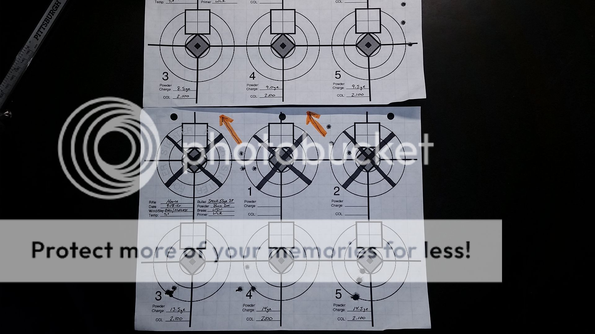

Here's what I'm talking about. The two fliers were my fouling shots. The two good ones, right after. This was about two weeks ago.
Again, a few weeks ago. Shooting just right, could be me.
Today's test loads. Not worried about shooting low, they're reduced loads. Was shooting for groups. But notice how they're an inch or more right. You can see that after shooting the first three loads that I adjusted my scope 4 clicks, which is an inch, and then shot about an inch left on my last three loads.
My go to load, shot today. I did move my scope 4 clicks, which should equal 1", yet now shot to the left about an inch. This group is 0.1845 at 100 yards.
