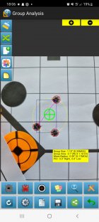

Hi all
I'm currently shooting a Howa 6.5 creedmoor
With a 24" barrel
I'm using 43.3gr of Vihtavuori N555 with 142 SMKs
This gives me a velocity of 2670 fps with a SD of 8 and an ES of 29 fps
With .7" group at 100m (9 shots)
And 1.2" group at 300m (3 shots)
What would be a reasonable accuracy goal out of a factory rifle

Howa has a number of different models in this caliber. I have a 6.5CM in the version that is in the H-S Precision stock with the internal aluminum chassis. I actually purchased the rifle because of the stock, vs the caliber. The only change that I made was to replace the Hact trigger with a Timney.
I haven't done a lot of load development with that rifle and have changed scopes a couple times. It was not difficult to get it to reliably shoot less than an inch at 100 yards. That is my expectation for a bone stock factory rifle. Until you start getting into custom premium barrels, I think that what you are showing is good precision for a Howa.
Congratulations, that is a very respectable group. if you want to push on. set those aside as your go to ammo and maybe try some 140 grain Bergers or Lapua secnars. i have a 6.5-284 and it did not shoot sie142s as well as the Bergers or JLKs. but the JLKs would be impossible to get down under. Lapuas not so much. Try N165 and see if you can get enough velocity to keep up happy as it will be way easier on your barrel the N555. N165 has a very low flame temp and is very clean .
