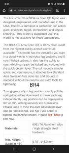

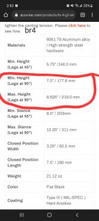

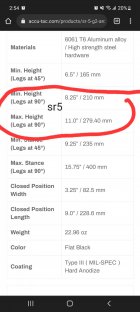

I'm possibly looking to step up my bipod game, and I've got a question for the Accu Tac users here. Besides the height, stance, and leg height position "stops", are there any differences between the BR4 and the SR-5 G2? It looks like the SR-5 G2 has alot more height adjustment for its size than compared to the BR4.
In the short term, I'll primarily be shooting prone, but possibly next year I'll be trying my hand at PRS style matches a little as well.

I had the SR5 after the BR4 was too short for me. It's great and stout bipod. I shoot a bit taller/higher than most people. So I needed it. But for PRS both be fine. The downside was the weight. It threw my balance point on some stages off with the bipod attached. Which can be a good thing if you got a thinner barrel.
Thanks for the reply! I was kind of thinking the height range on the BR4 could be a potential issue. @eric32 , are you running a picatinny-mounted bipod or ARCA on your PRS setup?
