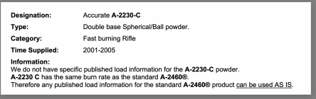

From my jug labeled "Data Powder - 2230-C from Accurate , McEwen, TN." Also from label -"A mil-spec ball propellant for duplicating the M-193 ball cartridge. Slightly slower than Accurate 2230. Use 2230 load data."

A2230C = A2460!!! ??

Doom posted above that it uses the same data and has the same burn rate as the Accurate 2460 which is a good heavy bullet powder in 223
